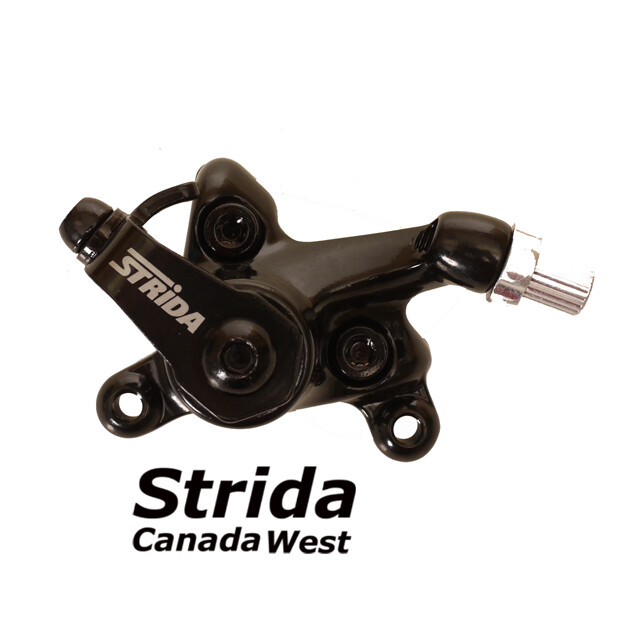

Please note that there are two types of brake calipers on the market;
on the older, rounder ones you can look at the pads from the underside of your bike.
Do yours look like these:
COLORED BREAK SET
or do you have the older version?
I’m asking because we didn’t check by now if the new calipers are using the same pads as the old ones.
If they do - hopefully - then you might try another type of pad in correct size,
please refer here for alternative pads:
