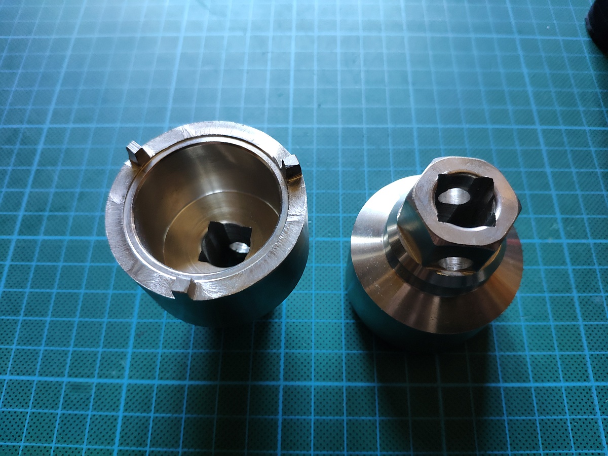

That means you need a special nut to change the belthweel because you have to open (close) the lockring.
Moreover that I’d recommend an electric (or pneumatic) impact driver to open this special nut, there’s a torque key necessary to tighten it.

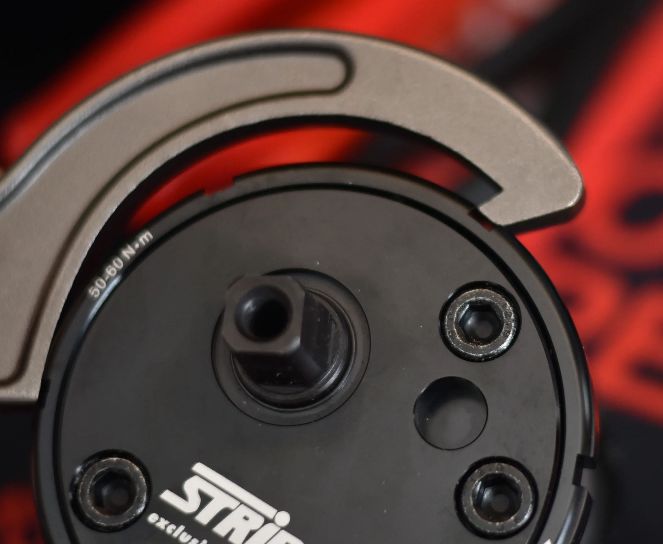

Below an image of the hook key, left the matching, modified one and right the original.

Even a best-equipped workshop would not have special Strida tools.
Yes, I’m pretty sure about this.
Especially that thingy below, it is the lockring nut:

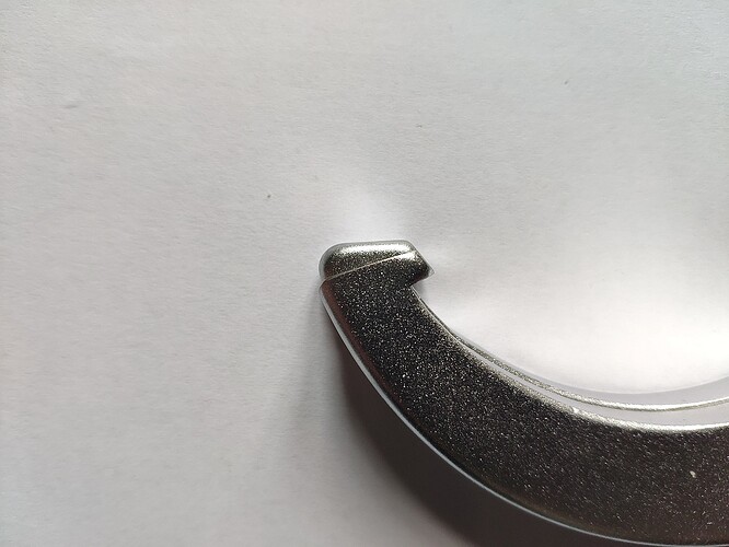

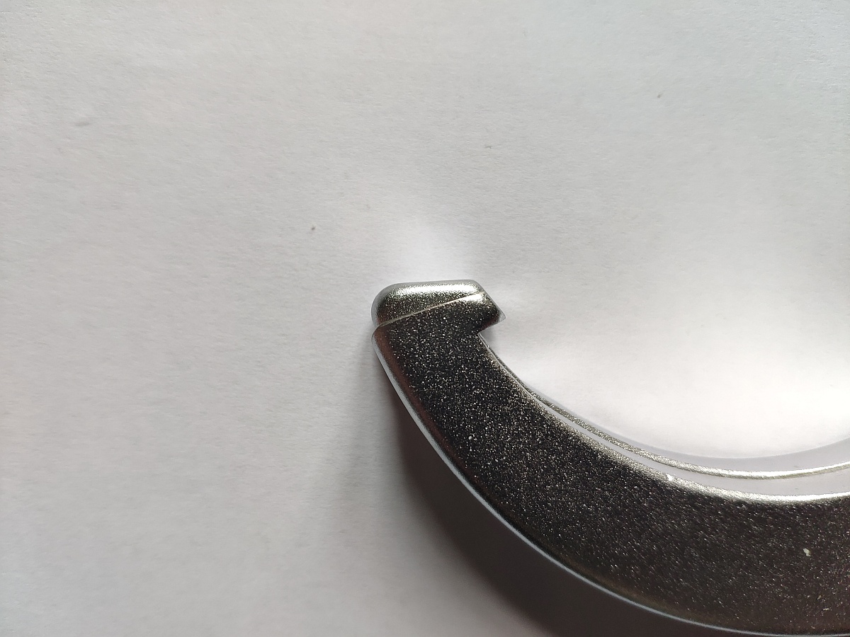

I bought a 95mm hook wrench two years ago and with your information I could see that it only caught on the locking ring by a tiny bit :rofl:
I am going to try to find a hook wrench with a thinner jaw. Fortunately there seems to be one in my country with a 4 mm jaw tip.

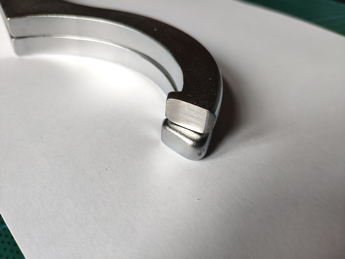

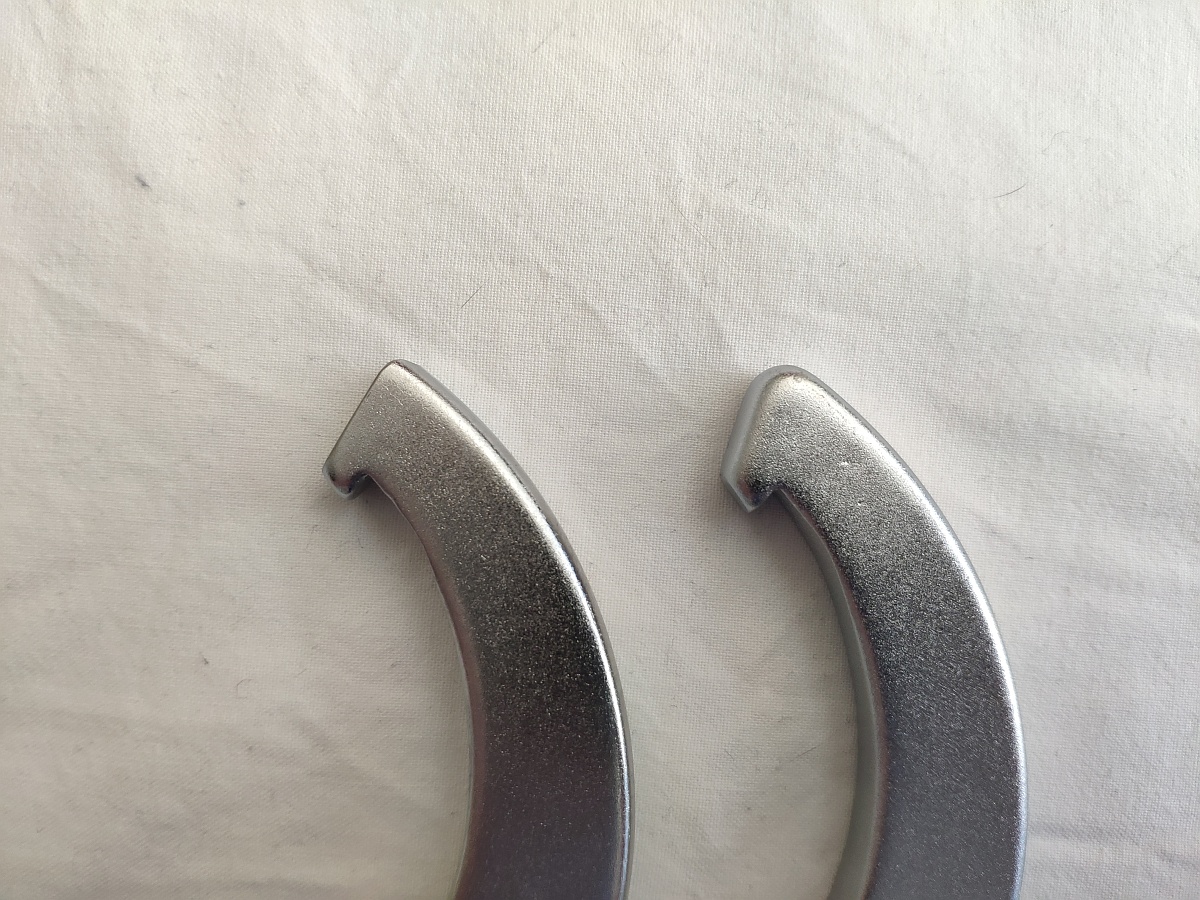

Hello dear Yakitori,
all you need is a grinder, a cup of cold water and some patience.
Grind a little bit off the hook’s tip, cool it with the water and repeat.
(Finally, break the sharp edges with sand paper.)
In the end, it should look like the left tip below:
