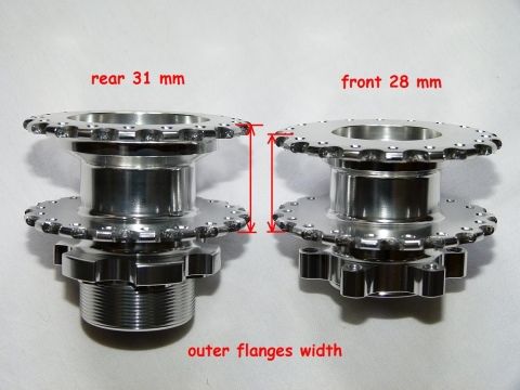

I would like to know if some people tried to put a dynamo hub on the front wheel ?
I already found a one sided hub practicalcycles.com/products/326 … brake.aspx
But it is not disc brake. So It might be difficult to find. Maybe need to be custom made.
I did some research before to ensure nobody ask this question already but I might have missed it.
My goal would be to have front and rear light using dynamo hub and the holes in the frame guiding the cables for the disc brake system. So a clean install.
Thanks !

I personally do not remember a modification like above mentioned.
Most likely will the dynamo hub be too wide and you’d need at least a custom made axle.
Strida hubs, especially the front ones, are unusual narrow;
- the dynamo hub will be to wide I’m afraid of.
Moreover that will be some kind of adapter required for the connecting of the brake mount.
Here’s another method, clean install is feasible, but it seems that there are no custom parts necessary:
Dynamo lighting system on a Strida

But I will study If a custom hub would be possible, as I used in the past both dynamo hub and dynamo on the tire, and I am much more happy with dynamo hub in wet condition, dirty conditions, and the overall sturdy design.
But I think i will end up with a custom made hub, changing the rim, So i need to see, Maybe even custom is not possible as you mention the strida hub is quite special indeed…

And furthermore, regarding custom hub:
Do you have any idea of the costs of a custom hub?
Expect several hundred Euros per piece if it’s professional made.
To find good rims will be the next challenge, obviously are nowadays very less people willing to lace a HQ 16" wheel - and according to zero demand there are less offers.

For the cost of the HUB I am not sure. But I can design it (I am a product designer), and ask a prototype factory to make it (maybe around 200-250 euros, I have no precise idea actually, but this part is not easy to make). I am not sure also which kind of aluminum is used for hubs.
The magnetic clip I skipped this problem. Sounds like this dynamo hub is a big challenge by itself.
So far Strida has been good in wet and dry actually. The drive belt is perfect in the city whatever weather comes in.
So I think I will buy front and rear light, buy a dynamo as the example you showed me, and see if in the future I can make the hub. But i am afraid the lengh of the hub will be a problem.

This shows the dimensions of the axles (upper = front); you may need it for designing a hub.
