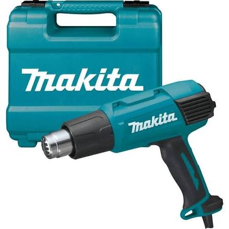

Regarding the application of heat to deactivate thread-locking compound, using a torch is not recommended as it can damage other components, while a hair dryer—reaching only around 120°C—does not provide sufficient heat.
To avoid applying excessive heat, I recommend using a heat gun capable of reaching the 200°C–500°C range.
