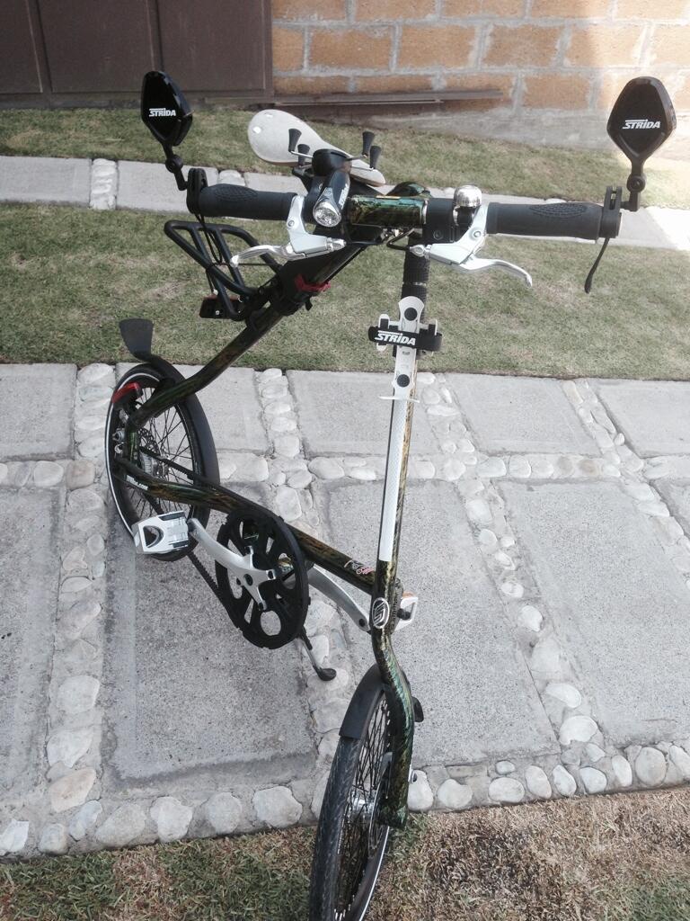

and I also found this:
pbs.twimg.com/media/BoG00oGIIAMuupM.jpg:large
that’s a Cambium on a Strida… ![]()
