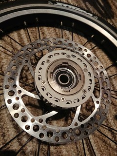

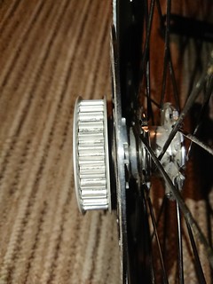

Anybody can tell me what is assembled before the wheel? I just came back to rebuild my old Strida and Looks like something is wrong… when I screwed everything wheel is not moving! ![]()
There is nothing before/below the wheels.
I’d guess that the brake calipers need to be adjusted(?)
You’re sure that the assembly of parts was correct as above?

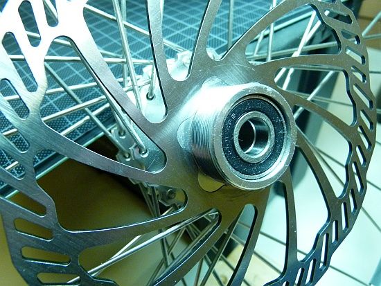

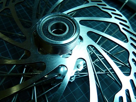

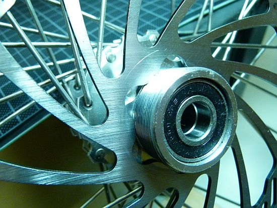

Sometimes images can help a lot…
It seems that you clamped the rear rotor not correct.
The distance from the outer edge of the hub to the bottom of the four freewheel notches is in your case about 4,6 mm - is that correct?
But it should be around 2,8 mm!
This is caused by the thickness of the brake rotor - it was not rotated correctly into its position at the corresponding profile of the hub.
You just need to open the freewheel again, rotate the rotor until it engages into its foreseen position and then tighten the freewheel - you win 1,8 mm and the frewheel won’t any longer get in touch with the frame.

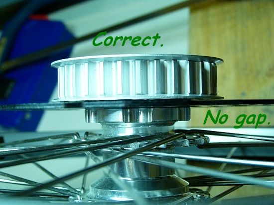

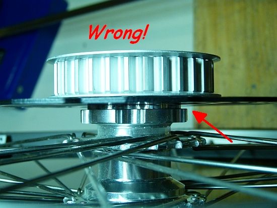

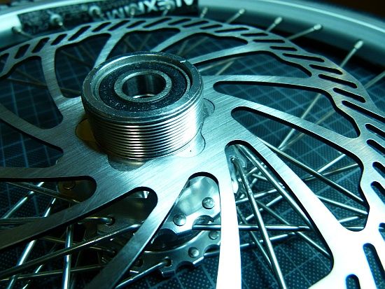

The “ears” of the flange and that of the brake disc have to match to each other, like teeth of gears:
I bet yours are in fact mounted like that - the “ears” overlap and do not match, this way:
Do you see a gap between the hub’s flange and the brake disc?
Once more, from a different angle;

Wait, wait…in that case it looks different - the gap is at the other side of the brake rotor!
An explanation could be this:
If you look at the actual exploded drawings of the manual you find a big washer (part nr.: 340-06).
Just, that washer was intended for the old plastic freewheel only.
That means if somebody would mount erroneously newer freewheel plus mentioned washer… ![]()
I found out what is wrong. After braking disc was Metal RING (340-06) that’s why was a GAP! I removed it and now wheel is spinning.
