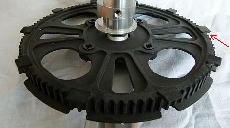

It has been a while and the good news is that the belt twist did not happen again - thanks to Blackstridaaustria and his friend! At the beginning of July I had to chance to to visit them and bring my Strida all the way from Germany to Vienna, where they fixed it.
Most likely the problem was part no. 338, where the ā€œdisc partā€ was bent. This allowed the rear wheel to twist several degrees under heavy load (=myself). The other part exchanged by Blackstridaaustria was the Freewheel, which was partially worn and the belt guard was beaten up a bit. From my point of view the main fault was part no. 338. Together with the worn Freewheel and a heavy rider the belt could twist.

Pic below for demonstration only, these are not Stridahd’s original parts:
At the first sight I was not fully convinced that such a small part is able to cause a twisted belt.
Now I am sure, thank you for posting!
