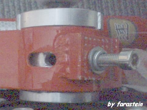

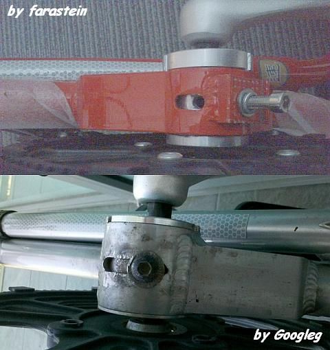

We have here a massive construction failure of a fake Strida:
As you can see above, the slots for the tensioning bolt are significantly different:
The slot of the fake Strida is much shorter than the Original one, because some idiot (yes, I mean it exactly that way) welded a block of metal on the bottom of the bracket housing, the block is covering the slot partially.
Of course, it is impossible to adjust the belt tension properly.
Obviously should this part (green frame) replace the kickstand spacer, but the builders of this “bike” did not understand the function of the excentric bottom bracket
Copying without brain will never work - greets to China!

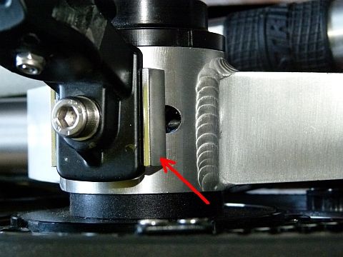

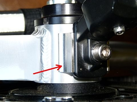

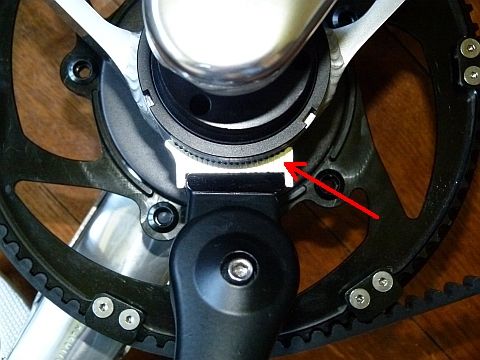

Here’s the Original kickstand spacer (red arrow), seen from the front, the rear and left side:
Naturally, the Original spacer is NOT welded on the frame, it MUST be moveable.
