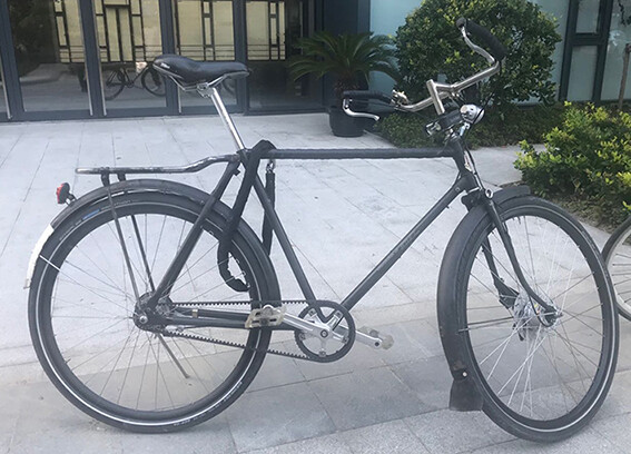

I transform an old bicycle from chain to Carbon Gates belt drive system and I found the belt really nice and strong compare to my first try with a similar belt like the Strida one which i snapped after 600 km.

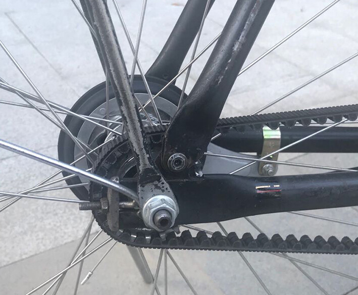

No not on a Strida, i should have mentioned. I installed a belt system very similar to strida, this belt have been used for a long time in Japan on city bikes. Anyway i mounted it on a city bike and after 600km snapped it. My freewheel was made from plastic by the way. I am not sure if it’s because this bicycle is more heavy than the strida or the overall design etc. Anyway i moved to Gates.
According to my understanding of a belt it must be impossible to mount on these bikes because the right chain stay is welded and not separable?
Ah I see, thanks ![]()
Honestly I’d never expected a construction like this on a that simple bike.
Also interesting the two roller brakes, these types of brakes are highly weather resistant but heavy I’ve read.
They do not break very strongly, but fine for city use for me. And i really like the fact that they are careless, same like using a belt and no grease.
Also I am using this bicycle on a fixed gear hub so breaking power does not need to be too strong.
But yes they are heavy, but this bicycle is heavy. This is a very old design, when frames were not welded. Riding a Strida in comparison is like being in the future…
