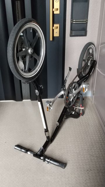

This is a past article from mixi, a closed community in Japan, but I hope it was helpful…
https://mixi.jp/view_bbs.pl?comm_id=19957&id=96371637
Although it is a machine translation, I have attached the English translation.
I will attach the image from the above article, but I will delete it if there is any problem.
I ride a Strider, and sometimes the joint at the base of the handle comes off and it’s difficult to fix. This time, it was dislocated for the third time, and this is how I fixed it, so please use this as a reference.
First, turn the rear wheel side of the main body upside down and place the rear wheel against the wall, and place the joint socket side on the floor and secure it. Then, place the front wheel with the joint ball on the socket and push it in, and the weight of the wheel will allow it to go in smoothly. Please use this as a reference.
