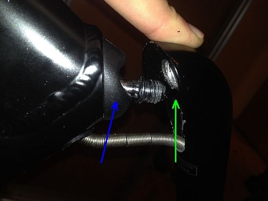

The ball joint at the top has unscrewed - here is the photo.
dropbox.com/s/ms4do8de8g9g6 … 3%2019.jpg
What do I do? How do I screw it back in, and how could this happen?

Hello Andrey,
I’m sorry to say…but I think that’s very bad.
Please note first that the ball is secured by a small hexagon socket set screw from the underside of the top joint.
The green arrow is pointing in direction of this screw keysize Allen 3 mm.
You will have to loosen that little bolt!
Unfortunately you won’t be able to screw the ball back in without unmounting of the blue arrowed part!

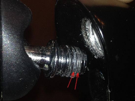

Furthermore, are these parts of the Aluminium frame thread?
I mean that’s a relatively complicated issue; you might need assistance of a local (Strida) bike mechanic.
Please be careful, you can make things still more worse (without, at least, detailed instructions).
Try not to pull out the ball by force, you would destroy the plastic part.

Look, the main problem is the thread of the frame!
If the Aluminium thread is damaged you cannot fix it.
We both will not be able to judge the condition of the thread, I’m afraid of.
If the frame thread is OK then could this issue be repaired, but it’s not easy!

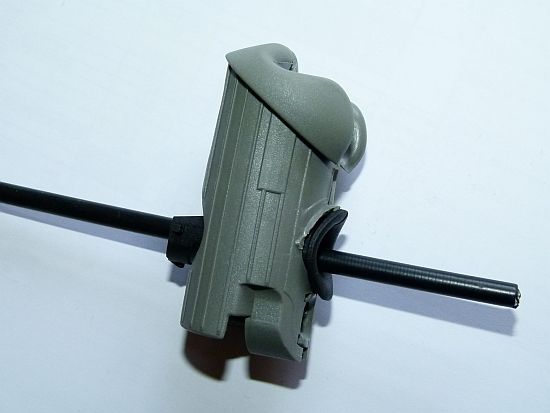

Guess you will understand the complexity of the required action soon…

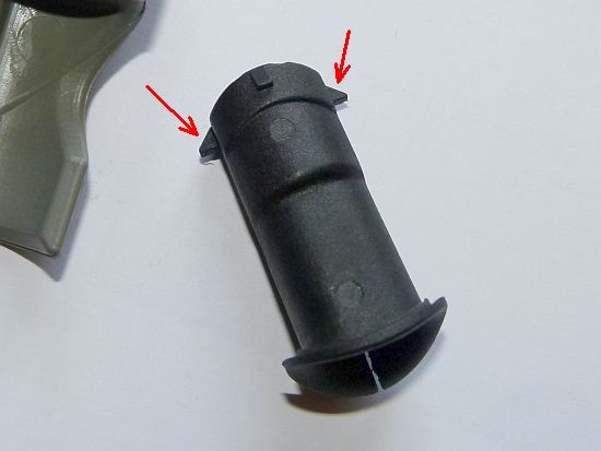

It’s a short version without parts numbers and hints:
Note: During removal of the black plastic part will it’s barbed hooks most likely break;
it should be replaced.
Well a damged thread in the frame could be repaired using a Helicoil insert. This solution has been existing for years and is even used to repair threads in engine blocks.
The condition to work is that there is still enough material to drill a bigger hole in the frame without weakening it.
