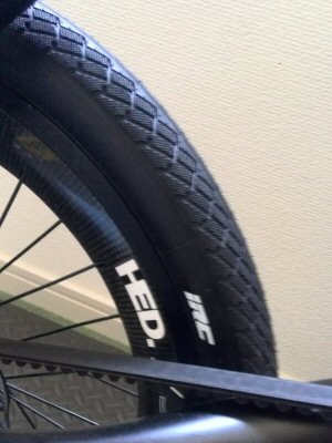

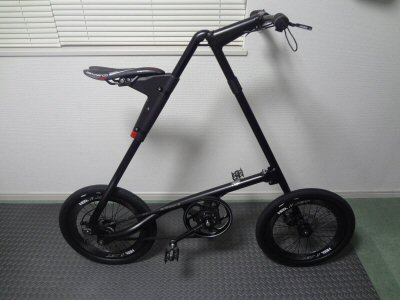

As you can see in this post; some Strider’s are using 1,5" width without having trouble.
I saw an 1,5 inch tyre life just one time, and this was touching the frame minimally.
