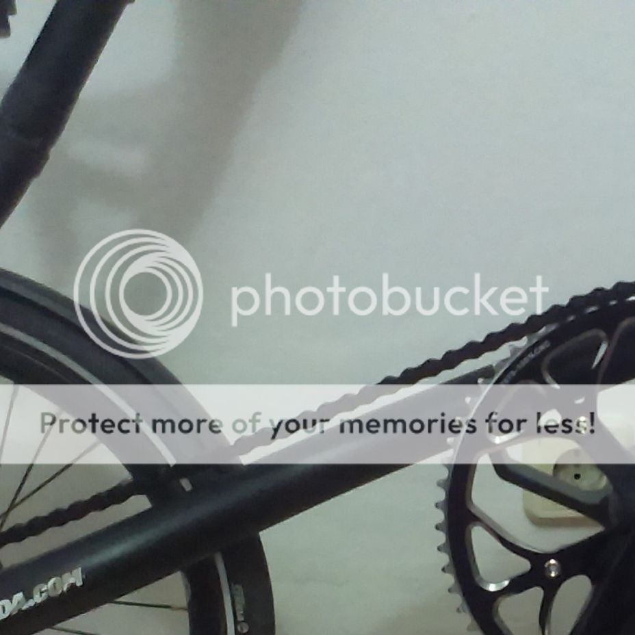

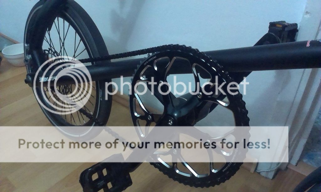

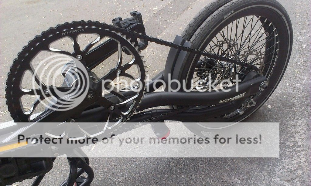

So, with the help of FB-Strida, Blackstridaaustria and P***** from Five Big I successfully get and made the change on my Strida 5 with 18 inch wheels. I bought the 60 teeth and 65 teeth chainring and also the 16 and 18 teeth freewheel just in case I’m to naive that I can handle the 65-16 ratio (4.06).
Regarding the ratio, it is a huge upgrade from 3.3 (belt) to 4.06 and in straight line you will really feel that :slight_smile:, in my case it comes with an idiot smile on my face.
Yes, I know, with this ratio you need more power (and time) to start from a red light, or climb a hill or anytime you have to stop/start, but in my daily 18km to work and back there are more straight lines than red lights/hills.
I tried also the 65-18 and it is easier when you stop/start again, but in my case the winner is definitely the 65-16 teeth.
If you don’t need higher speed you just want to get rid of the belt, the 60-18 teeth version is the exact ratio as with the belt.
There also some disadvantages like you have to be careful with the amount of oil you put on chain because if you put to much it will arrive directly on the rear brake disk.
Will I ever go back to belt? ONLY If this upgrade, in time, will be to messy, yes.

@Vandetta, yes that’s the chainwheel, i ordered the full kit from them. The link you sent is 100% identical with what i bought, and the price was also something like that, and yes you need a crank for it. It is not necessary to buy from them. One of the major problems after upgrade is that you will not be able to use the kickstand because of the crank from 5big… :frowning:

I can’t show you :slight_smile: with a picture because I’m 2000 km from my Strida :frowning: BUT i will try to explain.
The shape of the original belt Strida crank is a little bit “rounded” to go for exterior from the chainwheel, while the crank from fivebig is more strait.
Now, yes, you can set the crank not to hit the kickstand but then the chain (in my case) was way to loose and hit the frame… so i can not use the kickstand… I tried different type of chains (two) but not the chain is the problem, the problem is that the kickstand will follow the hub setting, and with that hub you set the chain :frowning: how tight or loose should be… so…

I believe to understand without pictures; the mentioned kickstand-excenter problematic applies also to the Evo as we know meanwhile.
Hmm, do you think a halflink chain could help?
I mean the main issue is the adjusting of the chain length.
Huarrrrgh - and it WOULD be so easy!!
Ming just had to refurbish an already existing proprietary part for the kickstand :imp:
