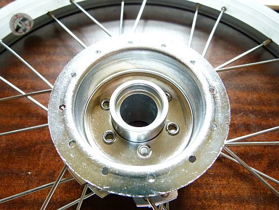

As I had never a plastic wheel of this generation in hands I'd really like to know if these are principially identical with the Strida 3 metal wheel version. Could you tell if the following technical details apply to your plastic wheels, too?
The flange of the pulley is not just a flange; actually incorporates this part also the brake drum.
The brake drum was secured inside of the hub (which is not separable from the pulley!) with six rivets:
One can see the heads of the rivets at the other side of the hub:
So, at least for my understanding, there is no chance for the flange to move - except:
- The rivets are broken (seems unlikely)
- The flange was separated from the drum "bowl" (seems even more unusual because this part is one massive steel sheet)
Besides of above mentioned: I think the flange can't be pushed off the rear pulley - there is simply no room to do that.
Consider that the flange is extremely close to the frame - you need to see that vice-versa:
The pulley can be pushed of the flange (drum) - but not the other way!
However, even if there are zero rivets inside of your rear wheel should it still perform well (just the brake won't work :twisted: ).
Inside of the hub should be bearings and a spacer, this parts again are secured by the wheel bolt (+ washers and locking mechanism) -
possibly there are parts missing or defective at the left side of the rear wheel...

Postby psull519 on Mon Nov 02, 2015 1:16 am
Hi, thanks for posting in response to my problem, I just saw your post. Mine is older and looks different. The flange is just what the manual says is peened on to the pulley. I cant do it tonight but I will take a picture of it hopefully tomorrow and show you. It seems like peening it back on to secure it now longer secured it adequately. Thank you, Pete

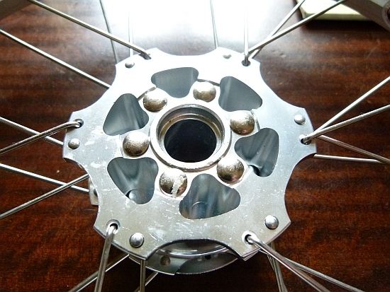

Postby psull519 on Thu Nov 05, 2015 12:23 am
This one looks like mine that flange pops off to the outside and the belt moves out off the pulley, stopping the bike. Then I would take the wheel off and peen the flange back on but it wouldn't stay on securely. So I thought of getting it welded on if that was doable but instead I used JB weld epoxy and so far that is holding and its working for me.

Re: MK2 Belt moves outward off rear pulley
Postby Blackstridaaustria on Sat Nov 07, 2015 2:50 pm
Many thanks for the pics; surprising to see that the "bolts" are in fact headless :shock:
The pulley's teeth are looking good it seems - I guess it wasn't ridden that much?
There are just a few little marks across the surface but the tooth shape is fine.
