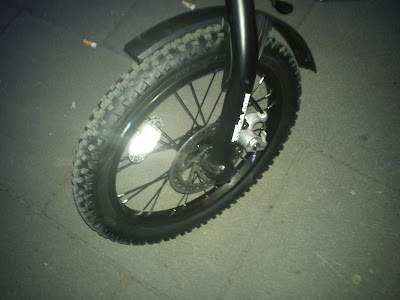

Your tires look very similar to these:
(source: lecyclocampeur.ch/bonus/1524 … elo-strida)
I hope the plastic is soft enough, because that’s the key for grip on snow.
Yeah, they are really soft.
btw Here is another thread on the forum about his voyages. I think he used different (maybe noname) tires for this trip.
http://www.stridaforum.com/forum/viewtopic.php?f=3&t=2733&start=0&st=0&sk=t&sd=a

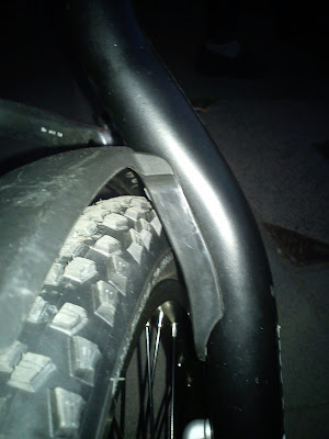

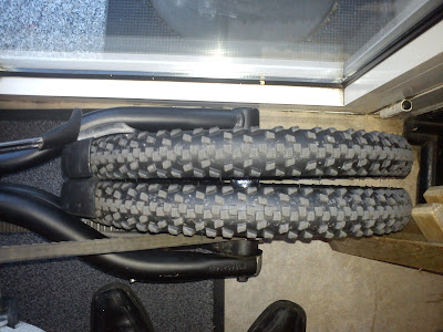

@Tom__: I can’t wait for your first rider’s report! BTW, where did you buy the tyres?
Ordered them in a local bike shop.
A friend got the same tires an put them on his Strida 5.0. They fit, even with the fenders. But here is not much space between tire and fender.

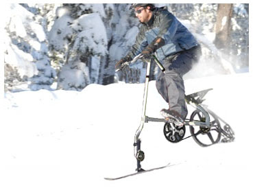

Hej Striders,
I know that it is not the right time of the year,
but does anybody know more about that thingy?
Found that accidentally at the picasa album of SiamStrida…
https://picasaweb.google.com/siamstrida/SiamSTRIDA02
This looks reaaaallly cool !
Ha, discovered, that’s a Ktrak snow bike conversion kit!
http://knstrct.com/2011/01/10/ktrak-the-birth-of-a-new-sport/
ktrakcycle.com/
(Ktrak website offline or discontinued)
Unfortunately, the reviews don’t sound too enthusiastic: forums.mtbr.com/fat-bikes/anyone … 51824.html
Which might explain why the website no longer exists.
Above mentioned thread (and the continuative links in it) explain that very well,
many thanks for your research StridaD!

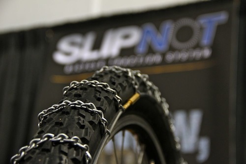

Maybe snow chains?
http://www.slipnottraction.com/

This is much cheaper and appears to work very well:
Tie wraps are light & don’t make noise when you ride on hard surfaces.
For more details, have a look here: http://www.dutchbikeseattle.com/_blog/Dutch_Bike_Co_Weblog/post/Seattle_Snowpocalypse/
