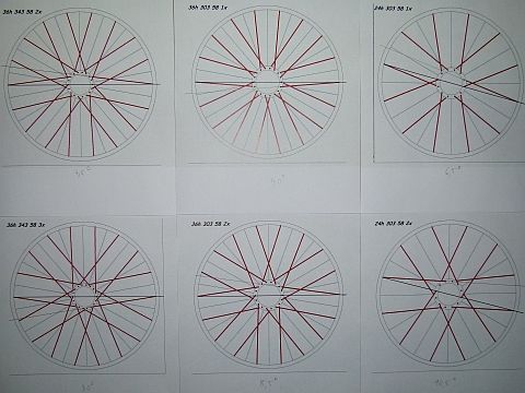

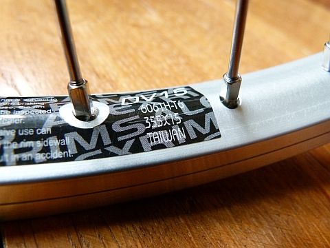

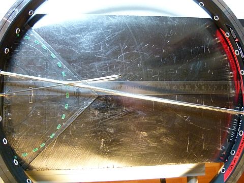

First, a few pics of original Strida wheels, here a detail of a 16“ wheel, there are 6 groups of 4 spokes in one cross (1x) lacing.

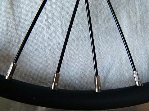

and here another group of 4 spokes at an 18“ wheel, 9 groups of 4 spokes, laced 2x.

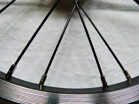

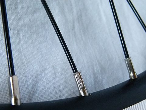

Clearly visible is the bending of the spokes near the spoke nipples –
this should not be!
What happens here exactly?
The spoke nipple cannot supply the required spoke angle, for example 7°.
Commonly used spoke nipples will not allow more than around 3°, I guess.

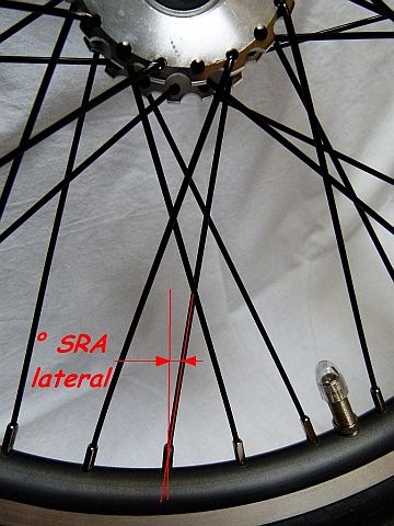

Theoretically, the best direction for a spoke to meet the rim would be in exact radial direction – technically impossible due to physical dimensions of the wheel parts.
Practically, the spokes meet the rim mostly not in radial direction, in relation to the radius there will be an angle, the nipple head seen as angular point.

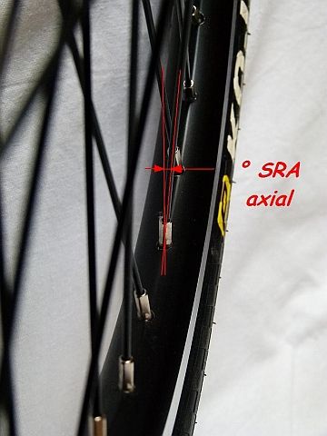

These bad „spoke to rim angles“, furthermore called „SRA“, will appear, to be more exact,
in two layers, one layer in direction of the wheel‘s axis
and the other lateral to the wheel‘s axis.
It is possible to decrease the axial SRA by:
- decreasing the hub flanges’ width
- increasing the rim diameter
the lateral SRA will decrease by:
- decreasing the diameter of the spoke holes pitch circle in the hub
- reducing the number of spoke crossings
[To give a dimension, the amount of lateral SRA on a Strida 18“ wheel, spoked two-cross, is around 7°.
The axial SRA of this wheel is lying between 7° and 9°, depending on the left or ride side of the wheel, seen in driving direction, - why that?
The middle of the rim does not meet the middle of the hub, which means (theoretically) that a Strida wheel does need different spoke lengths at the left and the right flange to supply the offset of ~ 3mm [front = rear = 16“ = 18“).]

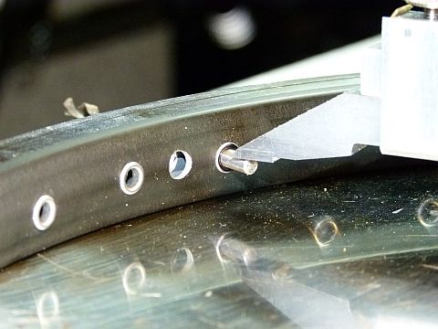

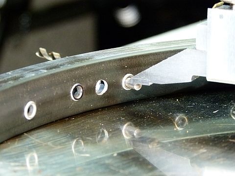

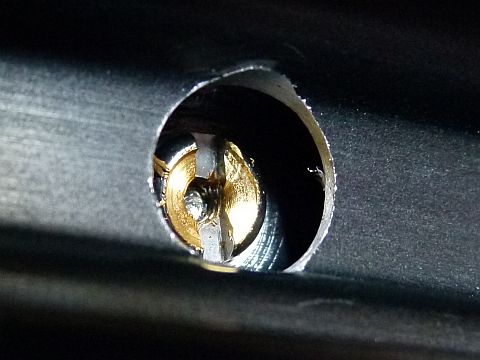

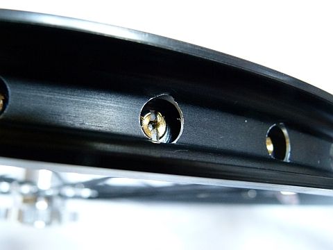

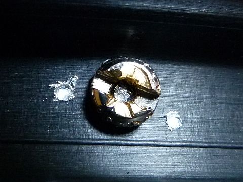

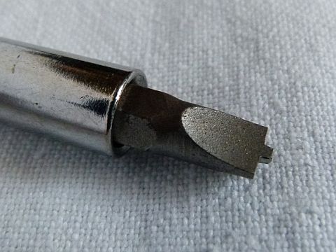

According to Sapim their „Polyax“ nipples should be able to supply up to 9° of SRA.
A German special bike shop told about the disadvantage of „Polyax“ nipples:
Question to Sapim:

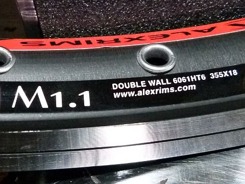

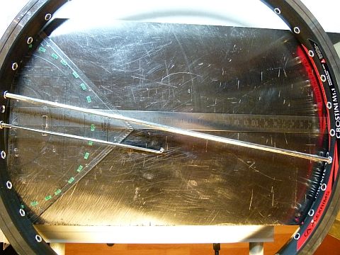

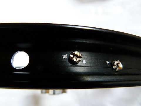

Interestingly, there is an alternative rim to the Alex DV 15, sold as spare part for the Birdy – the Alex Crostini M1.1.
The Crostini rims here
seem to be equipped with eyelets, on the other hand Crostinis are „offset“ drilled (according to the Alex website). „Offset“ means that the left and the right rows of nipple holes do not have the same distance to the middle of the rim.
By now I couldn’t figure out whether an offset drilled rim might be beneficial for a Strida wheel or not…
