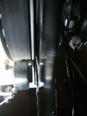

If your belt is jumping over the teeth you must feel that also with your foot.
Do you actually feel that?
Not sure, but…

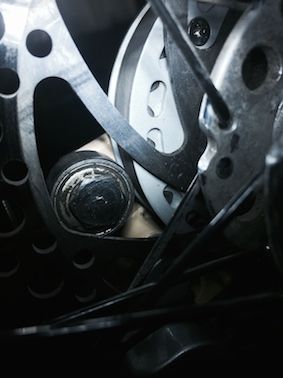

It seems you’re having the older snubber version with a recessed bolt (is that true?).
Back then was the snubber adjustable, nowadays it is not (straight, not recessed snubber bolt).
For me it looks like the gap (red arrow) between snubber and belt is too big.
Could you please try to adjust a play of just a few tenths of a mm?
In other words:
Move the center of the bearing (green circle - perhaps drawn exaggerated) closer to the center of the bolt (red circle).
From the ā€œTips from Markā€ pdf, point 8:
Three layers of common letter paper = approx. 0,25 mm
Please note: That’s regarding older versions only, newer ones don’t have this mechanism.
(The newer, Allen key headed bolt is not recessed like the older hexagonal bolt and there is also no counter nut.)
