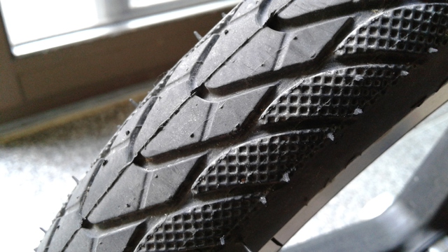

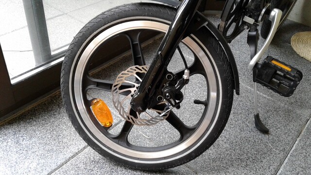

That’s my Strida wheel with the original 16" x 1,5" tire. The tire profile isn’t impressive at all.

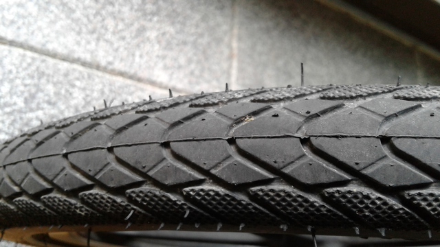

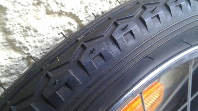

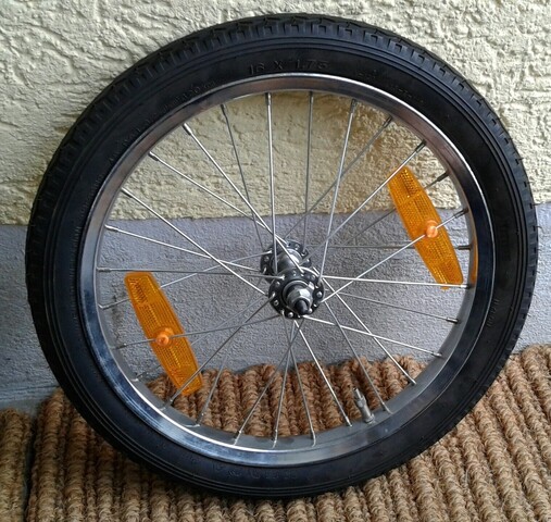

![](https://www.stridaforum.com/uploads/default/original/1X/3b9cbfdb57c1c6879020274598706b9002e2abfe.jpeg)
The tire profile isn’t something special:

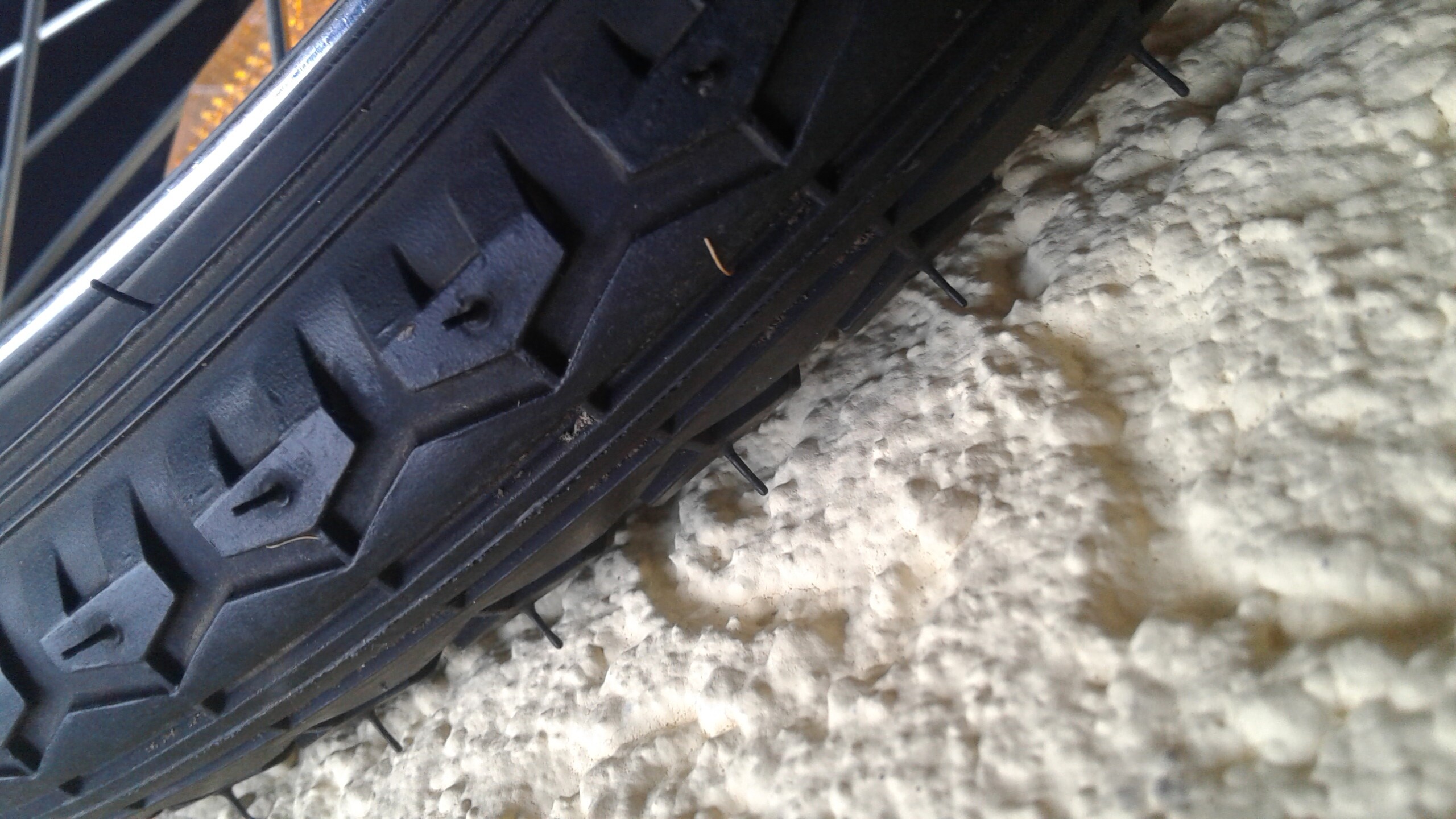

 ![](https://www.stridaforum.com/uploads/default/original/1X/bb99778ca2ad7b9a842de9dfb9aad95e1d56fd9c.jpeg)
 ![](https://www.stridaforum.com/uploads/default/original/1X/cee1cadecfb062a5f17ec596b5a95e535a0c5ee0.jpeg)
But the tires are at least a little bit broader (1,75 “) than the original Strida tires (1,5”). So I will try if they fit on the Strida rim.

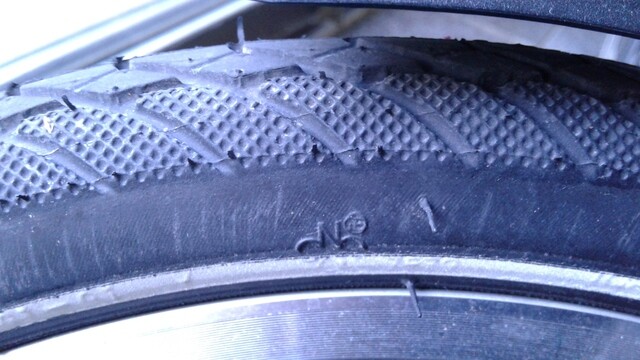

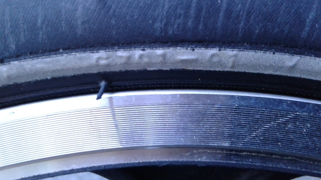

Yes, there is. But it’s next to impossible to read it. Because parts of the letters and numbers are coated with the white reflexing stripe.
![](https://www.stridaforum.com/uploads/default/original/1X/6f620d84f75dbd0a1073ab1c6e6a99c76b270d7e.jpeg)
C (or G) - 7?0?J? - C? j?
![](https://www.stridaforum.com/uploads/default/original/1X/7c0e67f93e146ecfd393de92ec66e8e13da67c25.jpeg)
dNd GB (in the circle),
the numbers besides the letters (at the right, hidden under the white stripe) 7 8? 7 0?
Is that any help?^^

Ah, okay. Actually I was confused because I thought that you would know any aspect of ANY original Strida tire .
The two 16 x 1,75 tires I have are from two different brands and so have different numbers. The one in the pictures above:
- Kenda
- Then the same symbol I had mistaken as “dNd” at the Strida tire and the number 1220
- Maximum recommended inflation pressure: 45
- P.S.I. 3.2 kgf/cm(hoch2)
- 320 KPa
- K - 123
- 16 - E - 116
The other tire:
- Ralson
- R - 3201, below: 2-3
- 47-305
- Inflate to 35-50 P.S.I. (2,41-3,45 Bar)
Do you think I will get in troubles when I install those two slightly different tires? (If I can install them at all. I haven’t tried yet.^^)

> [@Neon](#):
Yes and No.
On one hand you’re right, I should know them well.
But on the other please consider that I try to avoid the original tyres for a very long time - none of my four bikes has original tyres on 😆
> [@Neon](#):
You may have trouble while installing - or not.
I believe that exactly 1,75" is the critical border of this rims.
