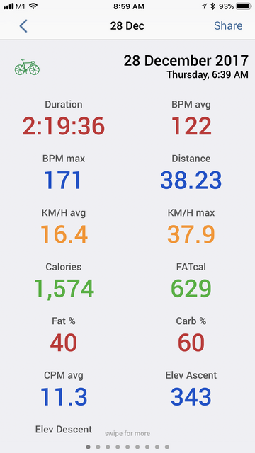

This is my usual run of the mill ride in the mornings - in this case just shy of 40km. Easy ride. Probably can go on much further if I had more time.
I would really like to dispel any myths that Strida’s are short distance bikes as the EVO model totally changes this.
Below is a screen grab from my iphone app iCardio - which I link with a heart rate monitor.
Distance is 38.23KM / 1,574 calories burned / 2hr 19min ride.

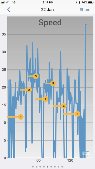

So this is my speed graph - so this is my approx 40km ride. The EVO easily clears around 18 to 25km/hr. It’s \> 2 hours ride - some stops (traffic lights, drink stop, etc).
Throughout most of this ride - I am on top gear. I sometimes wished the EVO had a 4th gear 😃 But then that would make the hub difficult to use (?).
IMO - the 1st gear is not useful unless you are doing 45 degree incline hills!
[![](https://www.stridaforum.com/uploads/default/original/1X/8943d1dca88f443762cce2a0b008ec884847b176.png)](https://ibb.co/govVeG)
How to read the graph:
X - axis is time (mins)
Y - axis is speed km/hr

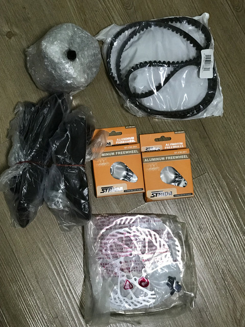

Just wanted to update status.
Status: Loving the Strida EVO more and MORE.
I stopped riding my other 3 bikes (which are chain driven and more gears) in favor of the 3 speed Strida EVO.
I don’t need to be super fast and I am on mostly bike tracks and some city roads. It’s fast enough to keep speed with inner city traffic.
Main reasons for Strida EVO love and what makes me ride it more are:
It’s kelvar belt - less maintenance as I ride 3-5 times a week with each ride being approx 40-50Km. With my other bikes I was chain cleaning every week.
weather has been hot humid and thunderstorms - no problems with the Kelvar belt! My dry lube on the chain bikes wash off!
People love the Strida - people stop me and ask what it is. It’s also a chick-magnet. Girls in general are not into full carbon kit road bikes or mountain bikes whatever… the Strida is a chick magnet! The number of times a random girl wanted to ride my bike =). It’s also way cooler than other folding bikes - the A - geometry
I will never ride a 1-speed Strida including the C1 Carbon – the 3 gears are fast enough to hit 25kh/hr which is the legal speed limit on bike tracks in Singapore. If I really needed speed I be on my road bike!
I love the 3 speed “back pedal” click to change gears !
An update on the bike - it’s done approx 10,000km - serviced it 4 times now at the local Bike Shop – nothing is wearing out or broken. Kelvar belt and the EVO Strummy Archer 3-gear box going strong. Wear and tear in general - like scratches to the frame from my neglect or general use. NO RUST anywhere despite lotsa wet weather riding. Rear tyre probably to be replaced this later this year (it wears out the rear fast - or a tire rotation needed!).
I upgraded my handle bars to the bent bar kit – totally changes the riding experience and pushes the weight of the bike more “even” as most of the weight distribution witht he default short handle bars (stock) is on the raer wheel. The bars are these at [https://stridacanada.ca/product/strida-bent-handle-bar-kit/](https://stridacanada.ca/product/strida-bent-handle-bar-kit/)
I personally love this bike so much - it’s a pity that the Strida is not marketed more aggressively. Even my local Strida reseller – NONE of them ride the Strida or can speak strongly on the advantages / disadvantages as they NOT ride it themselves - which is a pity.
To be successful on the Strida - it takes a few rides to get used to the “twitchy” aspects of the bike - after which everthing is GREAT. I see too many potential buyers of the Strida are put off by this (as the sales person does not know the product in order to relay the experience) or they try sell the Strida LT (which is very different to the Strida EVO from a riding experience!).

Below is a picture of some of my “in house” spare parts I bought to keep on hand - as I do love my Strida and I hate for it to be at the LBS waiting for parts to be ordered before repairs.
[![](https://www.stridaforum.com/uploads/default/original/1X/21c7d7e505b9c15bf5f05e026c7b56f3769c02fb.jpeg)](https://ibb.co/nyRjyJ)
From the diagram above…
Top left - my spare Strummy Archer brand new KS3 - still in shrink wrap. Given there is no need to maintain it, and it’s supposed to be what I heard is “self lubricating” I am very uncomfortable. It’s the heart of the Strida EVO and I keep thinking my existing KS3 gearbox will one day die… so I purchased this as a “spare”. I don’t want to have my bike @ the local LBS for “weeks” as they repair or service - if they don’t have parts.
Top Right - spare Kelvar belt. Sure the website saids 50K milage… it’s cheap why not just have a spare handy? My belt looks really worn out after 10K milage (teeth are intact though)… I can’t imagine it lasting another 10K !! Even though website saids 50K.
In the middle - 2 Aluminum Free Wheels. This is the other part I felt uncomfortable and would “wear out”. Amazingly I think due to the Singapore weather and my lack of “muddy” riding my free wheels have not had to much issues! I cycle generally on sunny days and but of late it’s been raining quite a bit - it gets wet but not muddy where excessive grit gets into the teeth of the free wheel. I am not saying it does not – it just is not the particles of sand grains etc which can do some severe wearing on the teeth. (I cycle on clear wet roads or paths – sorry to say I think Singapore does have some of the best roads in the world!). I also noticed that on several occasions when it rained on me and I was caught totally wet (me and the Strida) - the design of the freewheel has 2 “wings” circle structures on the outside of the teeth… they tend to block the water splashes - and when I touched the “teeth” in the freewheel it was in fact still dry or just “wet” only and all the road junk and grit was shielded by the “wings” on the side of the freewheel.
Left middle are 2 spare tubes - nothing to say much here.
Bottom is 2 Strida original disc rotors on spare… Probably didn’t need these but they here and spares!
Future CONCERNS of Strida Ownership:
1. I worry that Strida’s will become obsolete. I mean I don’t see many on the road vs say Bromptons or cheap supermarket bikes that cost 20% of the price of a Strida. So Ming Cycles stops production. In Singapore e-scooters are so prevalent now - they killing off recreational cycling. The cheap e-scooters cost 33% of the price of a Strida EVO - they quick, light and compact for commuting to office etc. And no sweating! They sold in supermarkets for the masses!
2. I got alot of creaking and I been checking the joints. Posts on this Strida forum of “sudden tube” failure scares me. I since wear a bike helmet ALL the time - as I do ride 20-25KM/hr average speed and in some cases 30Km/hr+. (okok it’s NOT the fastest bike but a fall as it’s an upright seating bike posture to the hard cement road would be very nasty at 25km/hr + speed if a tube suddenly broke! Nasty to my head! So helmet it is!). FYI - I am 200lbs! Not the lightest rider but well within the recommended weight range! I did pay specific attention and I DO think it is the kelvar belt rubbing on the chainwheel… can’t prove it. Creaks under load or hard pedalling. Silent when cruising or normal light pedalling.
3. My KS3 gear box dies…(that’s why I have a brand new one on standby lol as per my spare parts I am holding) - so I can swap one out for repair/service and other swapped into the bike). HOWEVER to be fair this is paranoid fear by ME… the KS3 is GOING strong still only the clicking noise when I am in Gear 2. I asked the distributor and they assured me it goes “forever” with NO maintenance required. I am used to bike maintenance regular weekly!!! I find this odd. The bike distributor only has 1 experience of another EVO owner who rode thousands (no idea how many!) and his KS3 was “loose” and would unintentionally change gears when it goes over any bumps. That other person was visiting Singapore with his Strida EVO – from Thailand.
4. I have to keep stocking up on Free Wheels (which are expensive compared to normal bike parts!) but as mentioned they seem to last for me so far. Now don’t blame the Strida, one of my other traditional 8-speed chain bikes - the chain ring was worn out by me in just 3 months of regular “my typical riding” and it needed replacing! (yes - 3 months - of 40-50 KM trips / 4-5 times a week). That chain ring was an original part and was stainless steel – I swapped it to an alloy so will see if that metal is longer lasting. That was kinda short lived on my other bike!!! So the Strida Free Wheel has lasted for me when I compare to my other bike! Just wished it was cheaper or as other formmers (Chester Tan etc) mentioned - can replace JUST the plastic teeth on the free wheel itself. I cycle for exercise and enjoyment so I am OK with parts costing etc - but I know many people use it as part of their daily commute and the concept is NEED TO KEEP maintenance and ownership costs DOWN. The Strida Free-wheel is over priced but I guess it’s more complex to make vs other traditional free wheels on the after-market - on common mainstream bikes.

Regarding spare parts collecting:
Good idea if you don’t like to wait for LBS orders.
The front rotors (140 mm) can be replaced by third party types, but the rear one (160 mm) has no bolt holes which is uncommon.
Also very unusual the belt snubber bearing btw!
