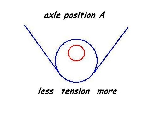

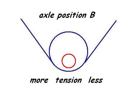

Surely you’ve meant 15 mm, I believe that is a bit too much.
Please note that the bottom bracket can be mounted in two ways, the pic below could be misleading:
(From this post 18" Wheel Upgrade: not that easy…)
All you need is a Ø 60 mm hook spanner (or an adjustable hook spanner of correct size).
