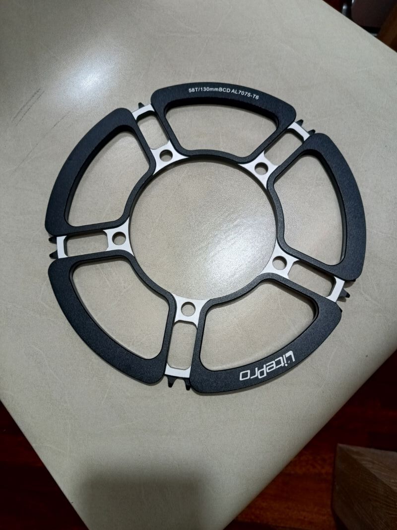

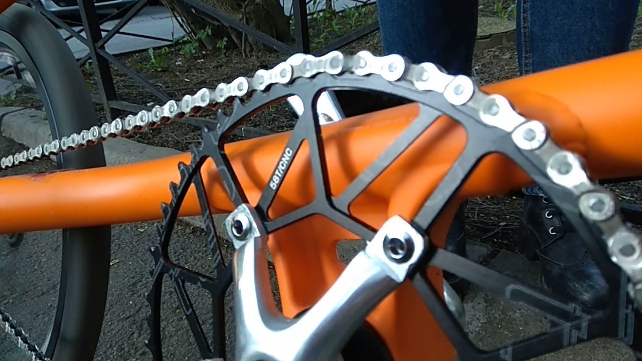

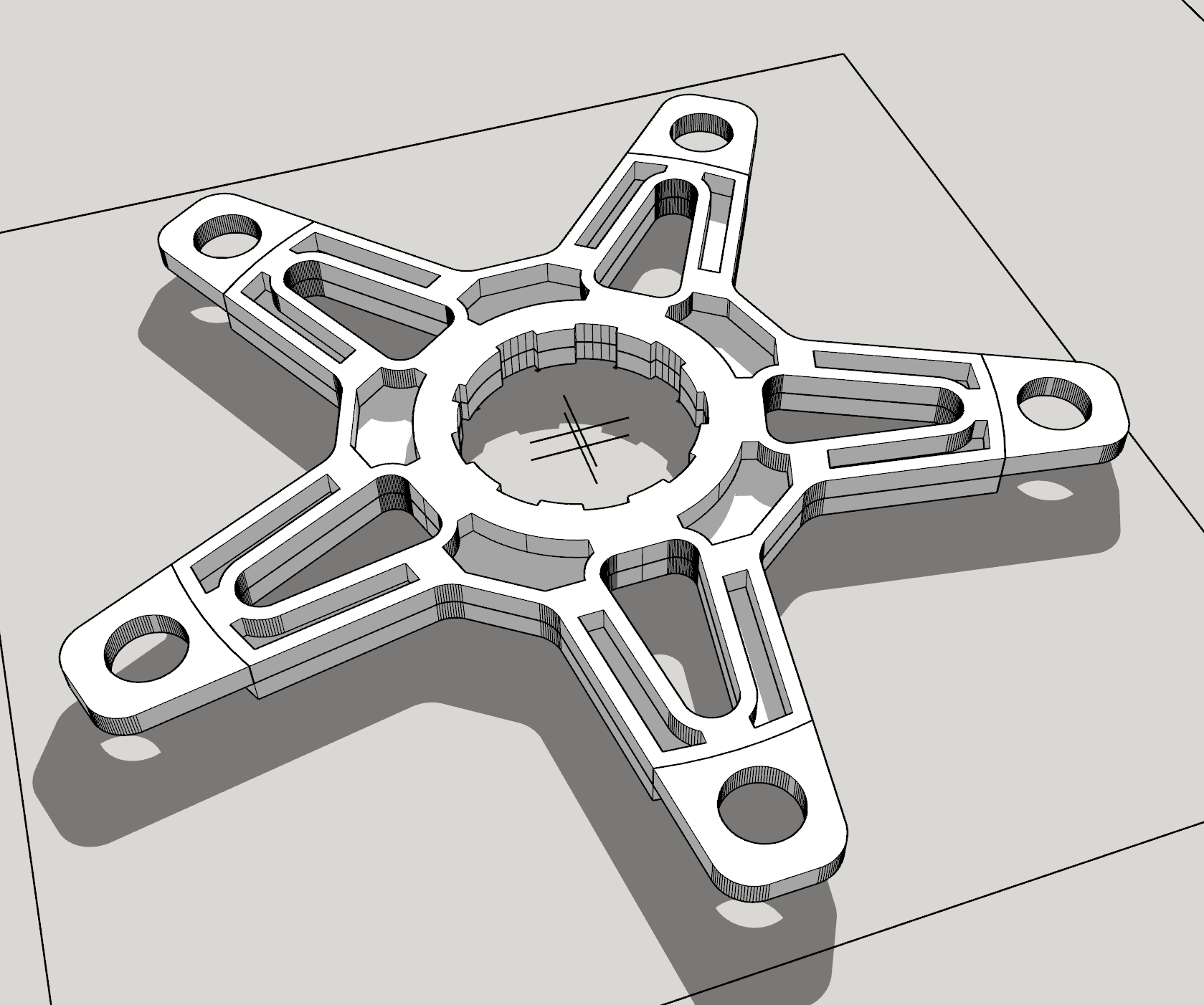

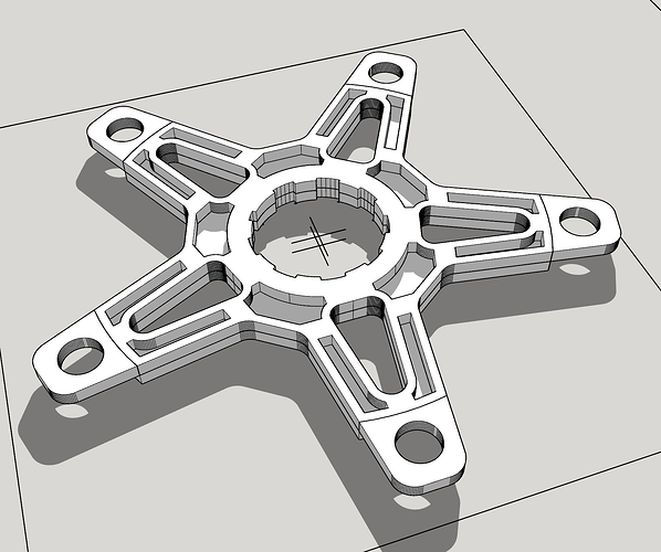

I have even designed in Sketchup such a part initially. Based on something like this

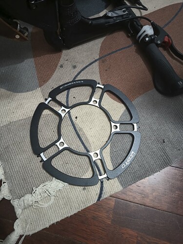

to mount exactly this
What I lack to complete the design is that damned key to took the plastic beltwheel from the Strida KS gearbox and check out and measure what is needed to be measured

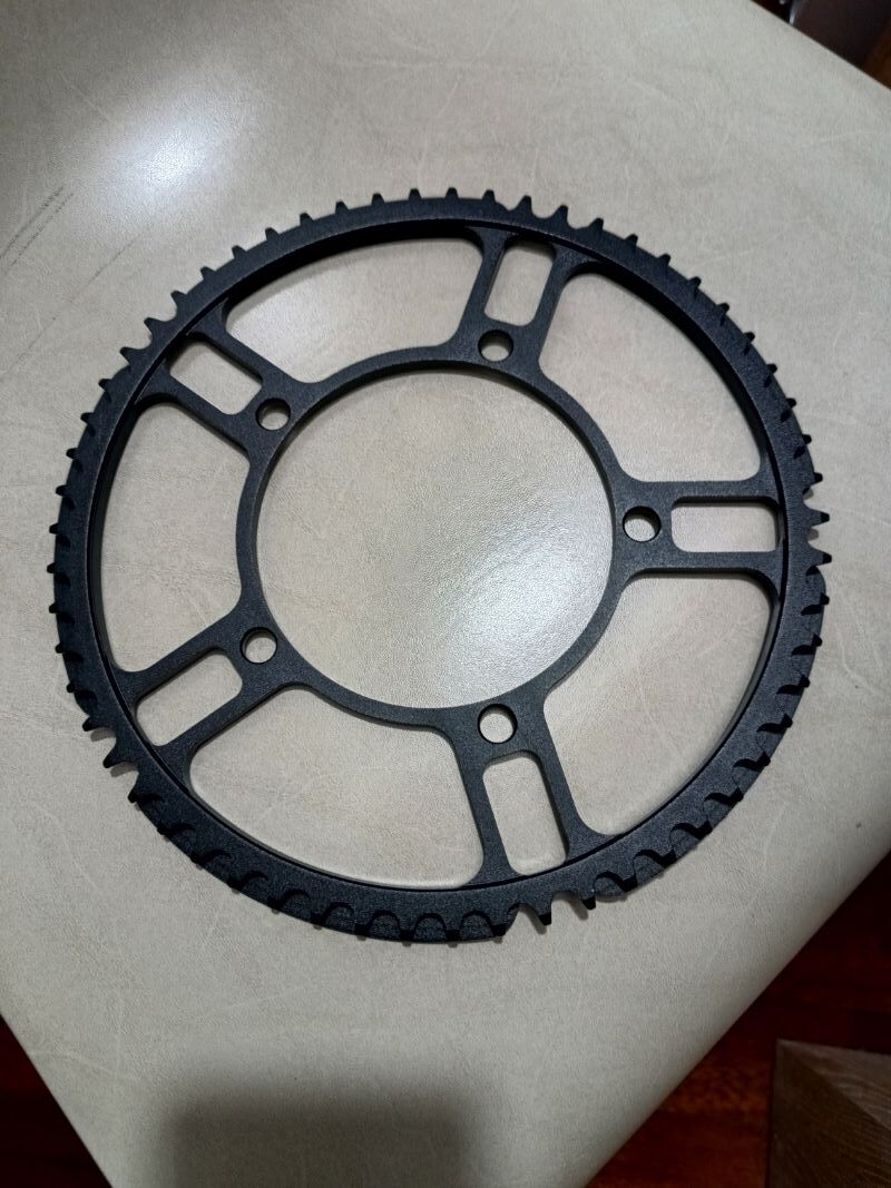

We are talking about such a part
I do not know the thickness of the inner circle to position the chainwheel properly to get the straight line of the chainwheel with the freewheel plus some spacers I have no idea should look like on that moment.

And all of that to put a 10$ sturmey archer 17T freewheel + 10$ chain + that big 58T chainwheel for about 20$ bought on Aliexpress :smiley:
to get rid of that belt and save 100$ a year on the strida freewheel only :slight_smile: And to finally push the crank with full power without wondering if the belt work properly while on the messy road situation :smiley:

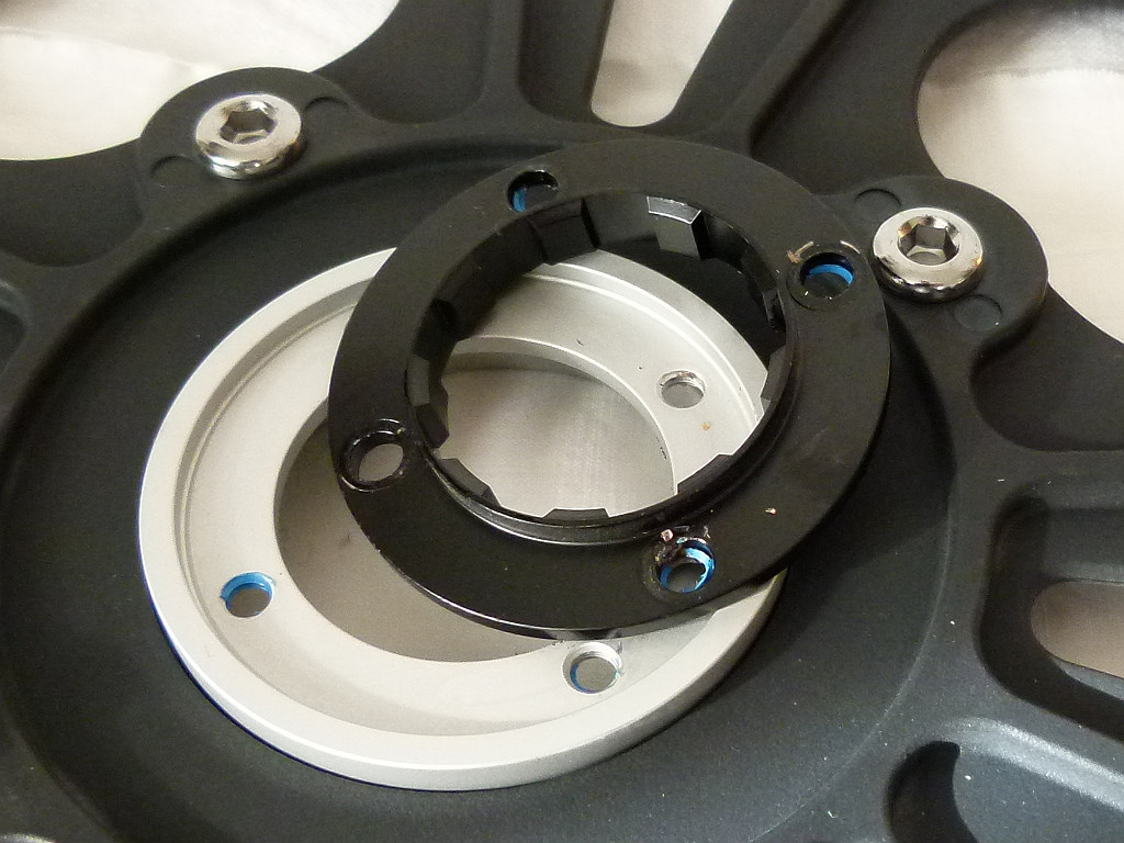

Do you know that document?
https://www.janeemussja.de/wp-content/2017/11/Strida_Lockringtool.pdf

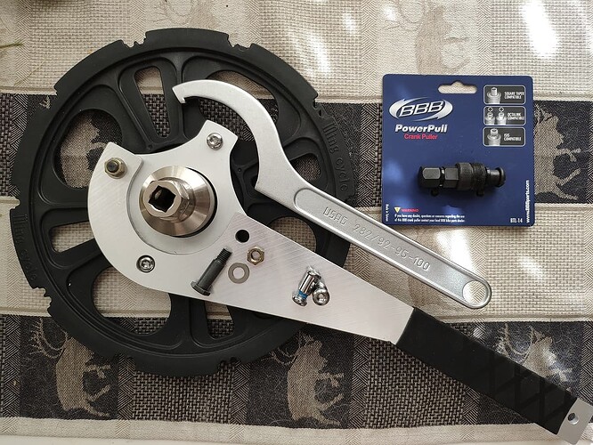

Recently I’ve created this tool set:
It is available (by deposit) for forum users (right now it’s in Norway).
Wow :open_mouth: very sophisticated :+1:
I was thinking of a simple disc to connect this adapter
to the chainring.
That tool set of yours looks awesome and would be very useful I suppose :slight_smile:

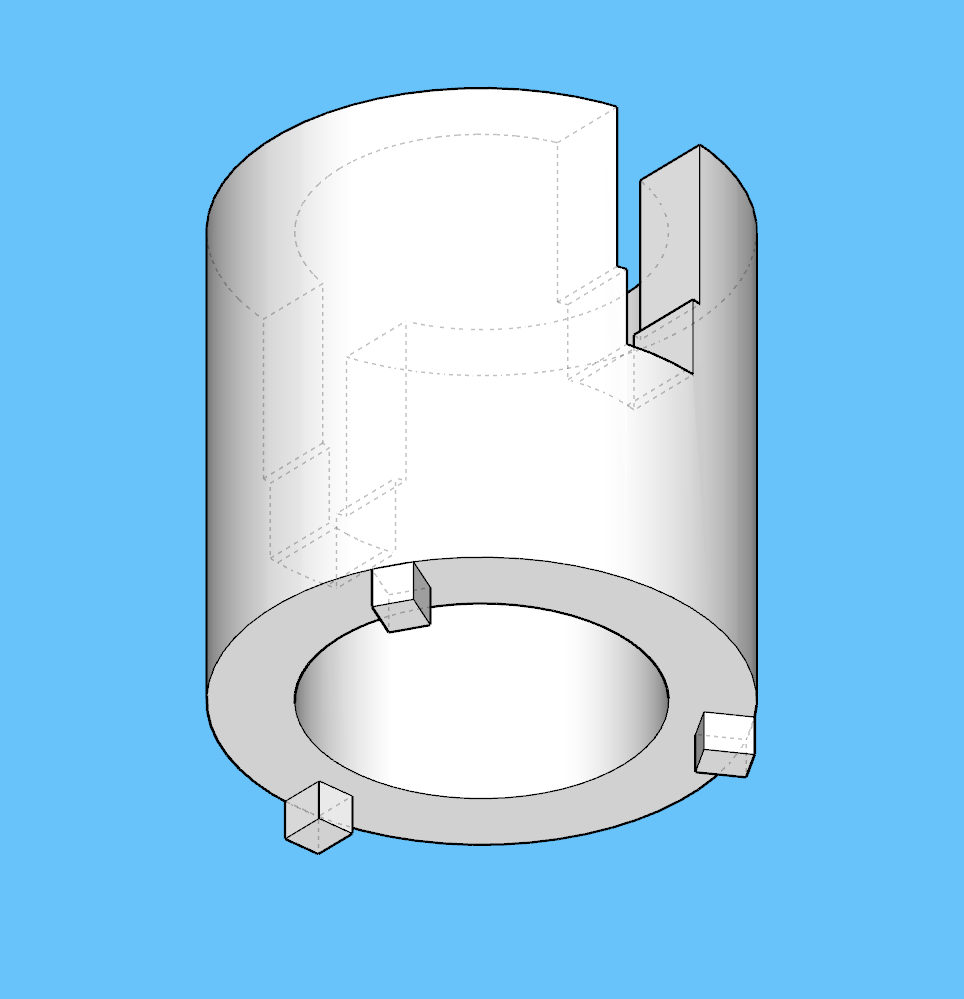

I didn’t know about this https://www.janeemussja.de/wp-content/2017/11/Strida_Lockringtool.pdf

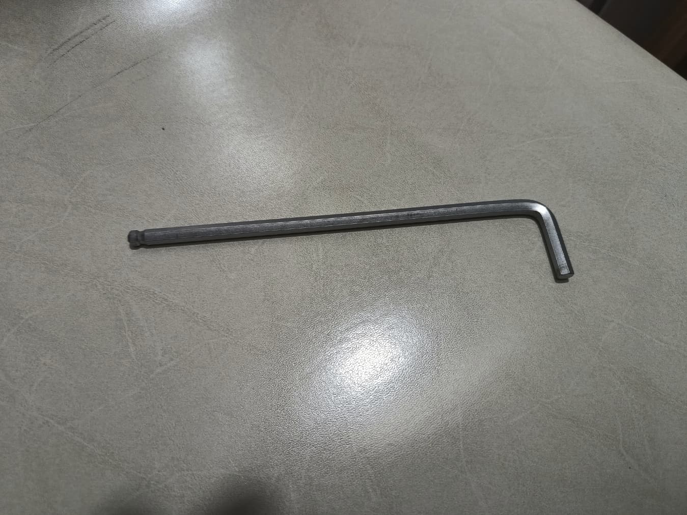

but I designed something very similar for my purpose in Sketchup to produce such a key for myself
The idea is to rotate that key with the lever made of two tools like that

Your adapter looks great, it is simple but I have purchased the chainwheel first :slight_smile:
and got started to think of some kind of adapter.
The design of my adapter looks sophysticated couse of the final weight not to be too high.
My design stopped for the moment couse I use Strida daily right now and got to keep it that way till the winter at least.

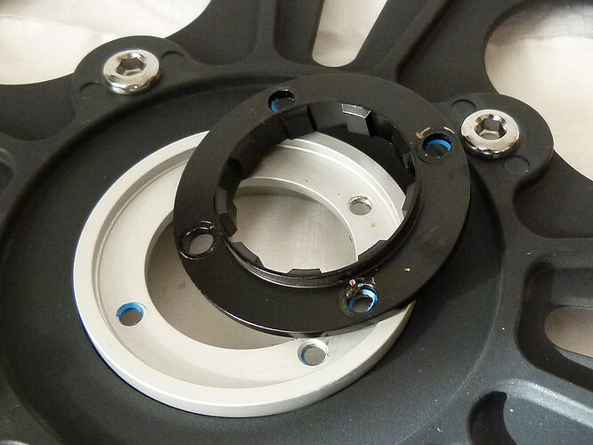

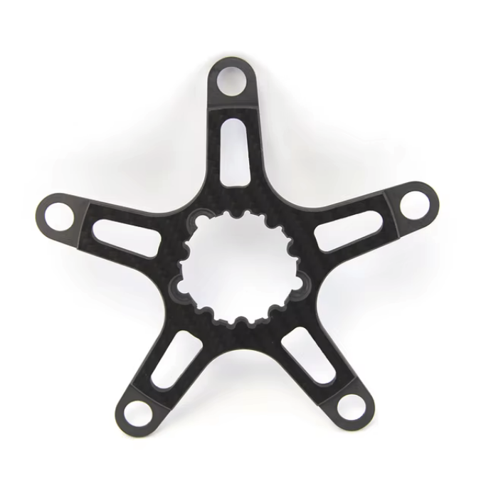

Here is the inspiration but it is Strida SX
best regards

Just to avoid misunderstandings, that is the original Strida adapter.
I think it would be advantageous to use a half-link chain, it would be easier to adjust the chain length, matching to the Strida excenter.
Good luck for your project, please don’t forget to post the result. :nerd_face:

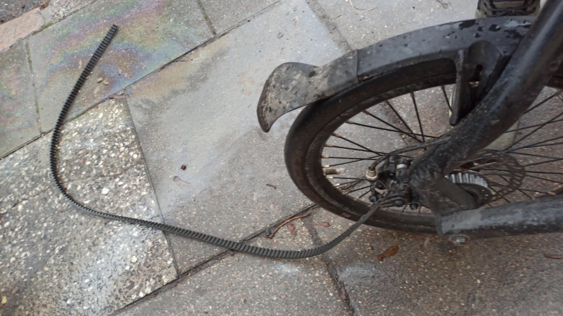

Hi again! :slight_smile:
Today again Strida tried to kill me when I started on green light - the belt twisted and was cut by the break wheel! :open_mouth:
Do you think the small metal wheel at the reer should be replaced? Since I replaced the freewheel twisting accidents reduced. No other idea what else could be the problem. :confused:

Hi Piotr,
I do still believe that the main reasons for twisted belts are:
  1. Too low belt tension.
  2. Misalignment between beltwheel and freewheel.
    Misalignment can be caused by a faulty rear hinge, but I think that part 338 (magnet spacer), at the left side of the rear wheel, has also “something” to do with that - part 338 has to be symmetric and not be broken or bent.
    Anyway, please try next time to keep the belt tension a little bit higher than before.
  3. Less common but possible: Damaged/disintegrated bottom tube bearing(s) - part 100-03, 100-04.
As long as the snubber bearing (part 389) is able to spin (and not stuck) there is no need to exchange it for my meaning.
