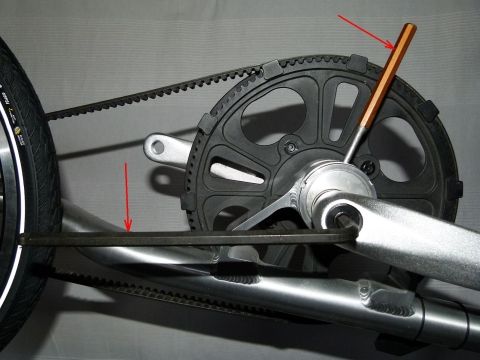

Sorry for bringing up at old thread … on my strida 5, i managed to loosen the ring but still not able to move the nut to loosen my belt tension
Any other suggestions?

If you loosened the “ring” (equal to lock ring, groove nut or the part 5 in the rectangle 130-00 shown at the detailed parts drawing, page 12 of the manual) - which part do you mean with the nut?

I was trying to slide/move part 274 after loosening part5 of section 130-00.
No matter what i do …the screw 274 does not move in any direction
Hello RLCH,
please try it like that:
Remove bolt 274 completely, after that insert a drift punch into the thread and move the bottom bracket excenter:
(Disregard the arrows and the Allen key shown below.)
Caution: Do not insert the drift punch too deep at ATS or Schlumpf speed drives - otherwise you might damage the shifting axle which is located inside of the bottom bracket axle!
