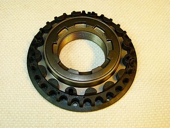

mstrida posted it already [here](http://www.stridaforum.com/forum/viewtopic.php?f=5&t=3764&start=0&st=0&sk=t&sd=a) and thanks to ilciavo I’ve got recently these new wheels in hand.
I was surprised once more; the thing inside is nothing else than a - slightly modified - common pulley 😲
![](https://www.stridaforum.com/uploads/default/original/2X/7/7a8e11e44219d93edbd39519c94e2046c2bd16f9.jpeg)
 ![](https://www.stridaforum.com/uploads/default/original/1X/d7b1b466685fdf952b4fdc7afbdf76add6e6ab90.jpeg)
 ![](https://www.stridaforum.com/uploads/default/original/2X/1/16ec473384306e0fb2c9b30a7f5fb2fff042ee0b.jpeg)
So we have here in principle again the old Strida front freewheel technique
- an usual part was combined with proprietary parts -
and I’m quite unsure:
Is this a step forward or backward?
What do you think?

Hmm difficult to say 😒
I don’t know about the first plastic freewheels, but from my experience, the weak points of the aluminum freewheels were:
- high drag when coasting
- accelerated wear of the teeth when riding often on dirty road
- water ingress in the freewheel mechanism
Is the freewheel mechanism still the same: has any seal been added?
Is a plastic pulley more wear resistant than an aluminium one?
It might just be a way to reduce the machining cost of the metal pulley 😕

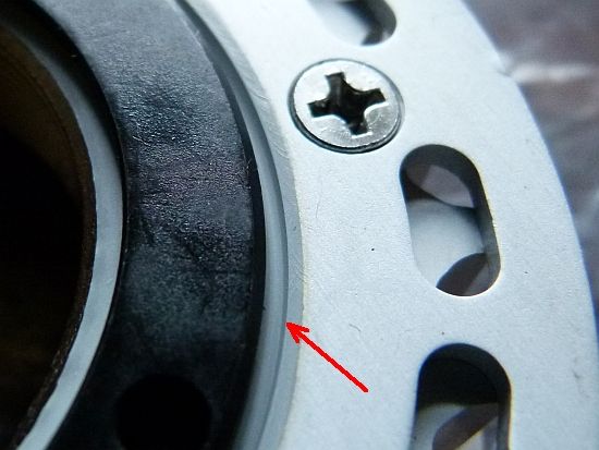

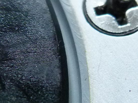

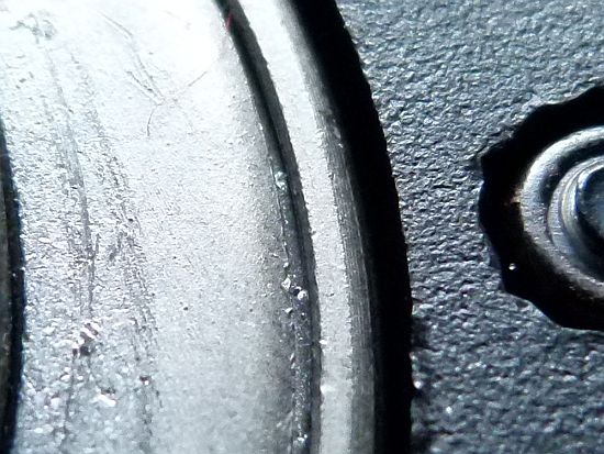

![](https://www.stridaforum.com/uploads/default/original/2X/8/8c54cd819ff004c59672a68890f1e334c8fc7f89.jpeg)
 ![](https://www.stridaforum.com/uploads/default/original/2X/1/1460727f058331cd6e9e96b4c289eb16e74bb524.jpeg)
but at the newer plastic one there’s just a gap.
![](https://www.stridaforum.com/uploads/default/original/1X/9c206d8be76ce77cee8d396964c4846d4efd5d11.jpeg)
 ![](https://www.stridaforum.com/uploads/default/original/2X/f/fd1cfbd06a377705df5198c83eb55d5538d8fc88.jpeg)

Friction is a good portion lower compared to plastic and there are much more “clicks” needed for full round, to be correct 60 instead of just 20 at the aluminium version.
You hit the gist of the matter with your final sentence I’m afraid of 😕

That’s pretty amazing 😮
I’ve used for the images above freewheels which are newer than that on both of my bikes, but the ones which are mounted are also equipped with this sealing. The only difference is the color; the older ones are black.
(And of course I can’t assure that they are also present on the inside of the freewheels, I’d have to unmount them before.)
These sealings were also the reason why I didn’t let anodize the outer rings, the risk to loose them due to the acid pretreatment was too high.
