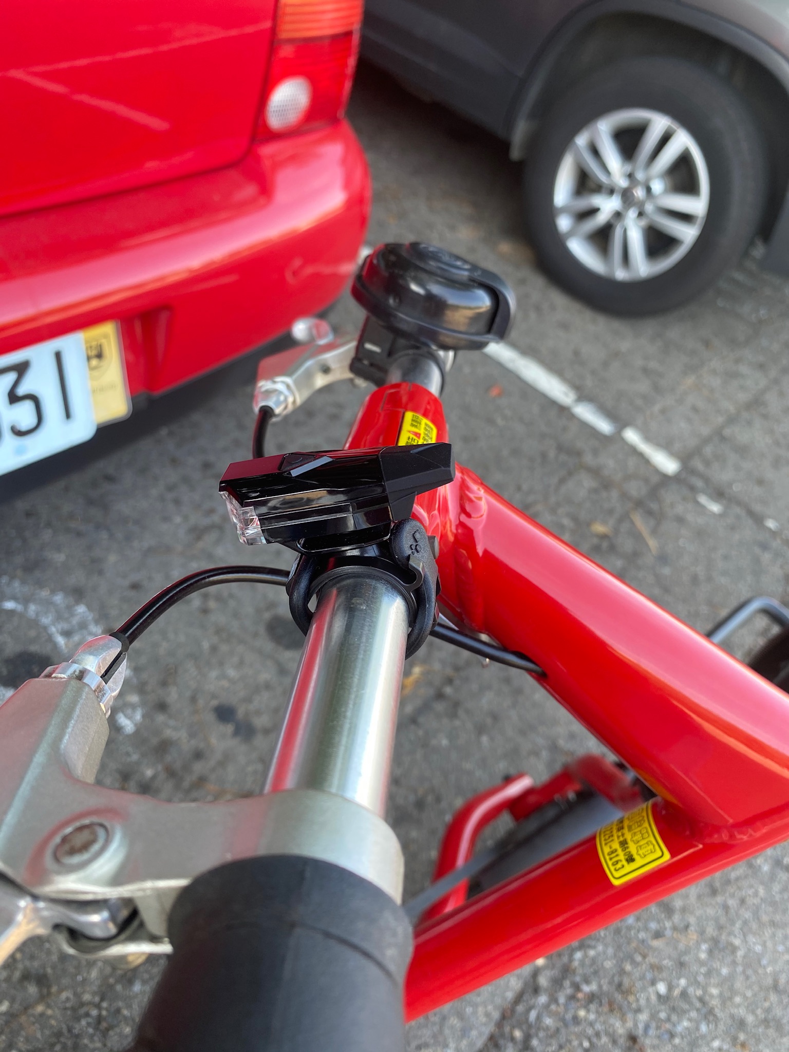

Here are two photos of my 4.1 . I replaced front and rear lights .
