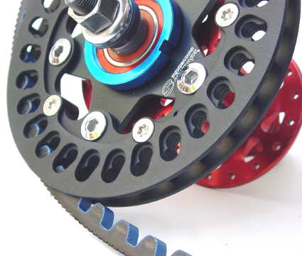

Don’t forget someone on the forums here also fitted a funky blue belt on their strida too from the autoparts store:
also you should try measuring the length and width of the belt and head to an autoparts store that will match those dimensions closely and has the same teeth pattern then you’re golden.
ah from this site:
tw.myblog.yahoo.com/Skywalker-St … &next=1917
here are the exact specs you should ask for in the autoparts store:
Belt length 1440mm
Teeth with tooth spacing 8mm
Belt width 13mm
the pics they show fit perfectly on the chainwheel.
