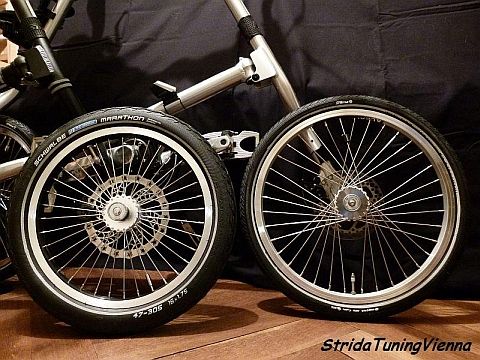

Like several other Striders I was interested to try wide tyres (and solve corresponding folding problems),
but I've switched soon to home brewn wheels...
...therefore, I'm sorry, I can not ensure which size of tyre might work with original (24 spoked) 16 inch Strida wheels.
But I can assure that the tyres Schwalbe City Jet 16 x 1,95, Schwalbe Big Apple 16 x 2,0 and the Schwalbe Marathon 16 x 1,75 (below left) actually fit to the used Alex Y 303 rims.
Alexrims / BMX page2
There's already information about wheelbuilding at the forum, please take some time to read it...
...and let me know what you're missing :D

Francesco91 wrote:I finally decided to buy those alexrims, so i wanted to ask you where did you buy them and how much did they cost to you, because i can't find the price on their site.
May I strongly recommend that you first order 18 inch Strida hubs for the planned wheel set?
(You did notice that you need 36 holed hubs for Alex Y303 rims?
16" Strida hubs are 24 holed, you'll also need spokes, nipples and rim band.)
Please let me know... :wink:
Naturally, here's the source list for:
18 inch hubs
the first (radial) set:
http://www.pedalkraft.de/felgen.htm
2 rims 16"/36H 70 €
72 spokes + nipples 28,80 €
2 rim bands 5,90 €
shipping D - A 17 €
the second (radial) set:
16" rims
http://www.dasfaltrad.at/
spokes + nipples
http://www.komponentix.de/
added for the 18 inch wheel sets:
18" Alex Crostini and DV15
http://www.simpsoncycles.co.uk/product.php/2202/birdy_wheel_rim
